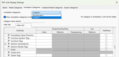

I am using multidisciplinary template (architectural + structural), and I want to hide grid that is showing up twice (as seen from the screenshot below). One grid axis is extendable, while other is not. The expandable one I need, the frozen one in the background I need to hide. How to do that? I wanted to apply filter, but could not define by which parameter because when I choose grid, it offers worksets, which I am not using for this project.  This section's discipline is architectural.

This would be the Grid in the Link File/Model
You can create a Template where in the Link the Grid is Turned off and then in the Project Browser Select all the Views you want to apply and right Click and "Apply Template" this forces the changes in but DOES  NOT assign a Template to the Views

SabinaK4RXQ
Thank you for the answer. I opened the linked file and turned off the grids in all floor plans and sections, but when I open the file where this one is linked to, I can still see grids.
Could you briefly tell step by step how to turn off grids in linked file? Thank you!
jay_colcombe
Create a New View Template based on a Structural Template and Duplicate it then rename.
Edit RVT Links
Set to Custom
Turn Off Grids - APPLY to all dialogues
Project Browser > Select All Views to Hide Architectural Grids > Right Click > Apply Template Properties
