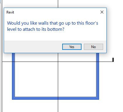

I am not getting anything about "joined" to walls. This is what comes up. Beginning to think something wrong with my computer.FLOOR SLAB.PNG
Message 8 of 9
bjur
You need to use the join command.  Cancel out of the default dialog box that always pops up asking you to join the floors.  I used it one and vowed to never use it again.  The join tool also gives you control on what order you join things.
