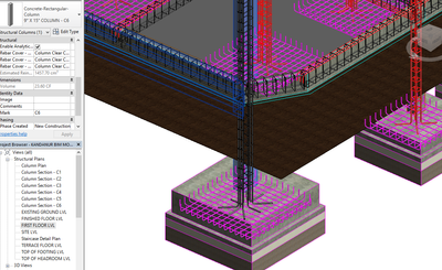

Having Problems with using filter
627 Views
Filter Setting for columns with mark contaning cFilter Setting for columns with mark contaning cThis column reinforcement doesn't change colorThis column reinforcement doesn't change colorand in another column only 3 out of 6 rebars change color
628 Views
-FDC-
Maybe the wrong host (footing instead of column)?
If you post your drawing I can check it.
Try to give that column in particular another mark and watch if the filter catches it
and if it did maybe it is just a regenerating issue in revit
if it couldnt catch it try to add another option to the filter is by adding the full mark of the column which would be c6
Also check that the rebars are in column not hosted be footing
How do i check /and change host for column reinforcement?
