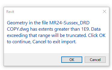

Geometry in the file... has extents grater than 1E9...
Please see error messages below.
I have exploded and purged CAD file numerous times. It no longer has anything to purge of explode.
I moved to 0,0,0 and there is nothing out in space when I zoom extents.
I have created a new file, selected via window and copied and pasted in new file.
I am still getting the error messages below
:Error 1.PNGError 2.PNG
I have been attempting this for over an hour and am unable to import or link the CAD file. Please help.

there is some random piece of data in that file. Is this  a civil file? if it is make sure they don't have a point way out there.
Message 5 of 17
I very much appreciate your willingness to help me find a solution. I have turned all layers on and deleted most of the drawing except what I need. There is not a point that I can see outside of my screen. I do appreciate your help.

another possibility is that the file has elements with various z value and some are out of range. It happened to me before. Try to flatten and then manually check z values for all element types.
Message 10 of 17
I appreciate all of your help. I had to have the author of the file make some changes. I am not sure what was done but it works now. Thank you for your replies.
Message 11 of 17
This happened to me.. after putting my detective cap on, I found that some hatches had an elevation of -9.900E+29.. So I got rid of these hatches and it was all good. CAD was an output from 12D, a specialist civil package. The tell tale is when you orbit the 3D CAD and hit zoom extents, it will all disappear into space. then when you Ctrl+A to select all, all you could see is a dot, meanwhile you have a gazillion items selected.

I had a similar problem there was nothing on the plan to suggest that there is anything in outer space. I resolved this by going to 3D Views>Left/Right/Front or Back. Lo and behold there were two ploylines floating near the moon. Once deleted everything is back to normal.

Chiming in as I just encountered this problem.  I was unable to locate whatever point(s) line(s) that were in a different galaxy based on methods in this thread.  However, I did turn off all hatch layers (turning off alone did not work and I was unable to delete them); then copy/pasted to a new .dwf and pasted to original coordinates.  This solved my problem and appears to be working great.

Glad you got things sorted in the end. I posted something online a while ago here that may shed some light on this. Basically hatch origins can cause this message. I hope that helps
