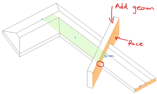

I want to create this rebar distribution. The rebar lengths A and B have to be variable.
ovidiu_paunescu
I recommend you use the aligned distribution and use the following steps:
Select the 3 faces as the host surface
Select the distribution path
Set the layout, bar type, etc
After the set is created, edit constraints > select the align / close bar handle and choose a face to which the bars will be parallel
Trim back the bars by editing the offset at the desired end
OR, use an additional geometry (that can host rebar) to trim back all the bars to a precise position
Select the set and change the workshop instructions to "Bend"; this will match the rebar to a revit rebar shape and extract the segment length.
The bars in a set can match to different rebar shapes.
To change the parameters extracting the segment lengths, find the shape in the project browser, edit the shape family and change the assignments of the various segments.

That worked perfectly, thanks!
