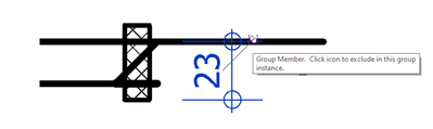

semi
Indeed, like L.Maas mentioned above, you can make a detail group with a dimension attached to it for easy usage in your detail views:

semi
In a detail group, you can hover over any detail and click on the group member icon to make it invisible:
you can also restore it:
No messing around with families needed.
