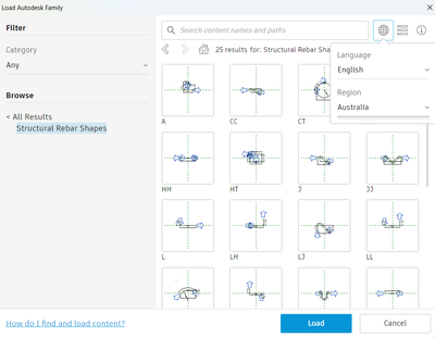

At present you have what is supplied with your regional install and hopefully these meet the requirements for said regions/countries.
You do have access to other regions from the Insert Tab > Load from Library Panel > Load Autodesk Family
The only other advice I can offer is Third Party Add-ins for Rebar Detailing are far more comprehensive and offer much more accurate and expansive libraries and often package up Shape Codes as families within them.  You could take out a trial and see what options are available to you and copy those files for future use?
