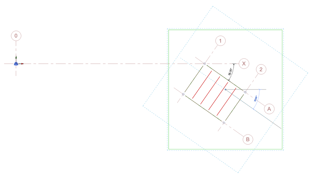

We discovered an odd behavior with a rotated Crop Region when applying a View template from the Enable Temporary View Properties tool.
Here, I have a rotated Crop Region done the most common way:
Here's the result after the rotation, which is what we want:
Now, when I apply a View Template using the Enable Temporary View Properties tool, I get the following result:
Notice how it rotated the view back with its rotation center at the Project Base Point? This is caused by the Orientation parameter in the View Template being set to "Enable".
Now, when we restore the Temporary View Properties, here's what happens:
The view gets rotated back but the Crop Region remained at its Temporary View Properties location, which is incorrect!
Note that unchecking the "Enable" checkbox from the Orientation parameter in the View Template would not cause the Crop Region to move like that.

Hi Patrick,
I can confirm this behavior in Revit 2021.  It is a bit weird.
The easy fix and probably a better solution than rotating crop regions is to create a scope box and assign it to the view, then this behavior does not present itself.
