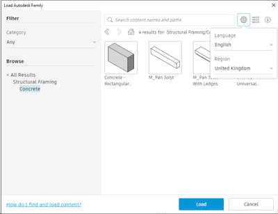

  1. Hi, I'm a beginner level user of Revit. When I try to model concrete beams the option for that is not available, the only available option for me is steel beams C shape and W shape. please help me find a way to model concrete beams. Thank you

Hi @1002057886 ,
You may use the template which no concrete section family. Let follow these steps:
Or your can use the Properties pallet>Edit type>Load
I hope these steps may help.
ennujozlagam
https://forums.autodesk.com/t5/revit-structure-forum/concrete-beam-and-column/td-p/8375701
jay_colc
The above method is typically recommended, however you can also chose from the Insert Tab > Load from Library > Load Autodesk Family
You can then search more easily and per Region
