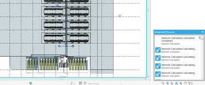

Randomly cannot save my project. Not sure where this should go in the forums but I work mainly on structures so I figured here will do.
This is the second time I'm getting this error today and I've had work colleagues get similar errors and no one seems to know why or how to fix it?
As you can see from the image there are no background calculations running. They're also all turned off where possible. I have no idea how to get around this issue.

Hey guys....
1 Remove all connections
2 open new window
3 close the new window
4 go back to your model
simple as that 🙂 it did work with me

andres_gallo4VLKE
Hello everyone!
I understand that some of you are experiencing difficulties when trying to save your projects in Revit, especially after copying a steel plate. I have found a solution that has worked for me and might help solve this problem:
1. Open a new project in Revit.
2. Save this new project in your desired location.
3. Now, go back to the original project you were working on and try saving again. This time, it should allow you to save without any problems.
It is important to note that, to avoid future problems when saving, it is advisable to model the steel plates from scratch instead of copying them from other projects. This usually prevents problems that can arise when trying to save.

Found the solution! It occurs when making changes to the steel plate or connections. I simply undid my actions, re-moved the plate, and now everything works fine.

JeandreVDM
Hi @daniel7FDRJ
I managed to get around this glitch while working in Revit on structural connections, encountering the same error message.
Here’s what you need to do:
  1. Keep your current Revit file open.
  2. Make a copy of the specific Revit file in your windows explorer and then open the copied file.
  3. Now, both the original and the copied files are open in Revit.
  4. You should now be able to save your original Revit file.
I hope this works for you. I've done this more than three times today, and it has been successful each time.
After saving your file, close and reopen it to "refresh" Revit. This should ensure that your connections work fine again with quick background calculations.
