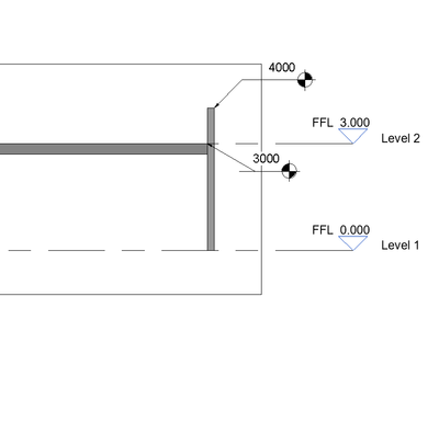

Is this a Section View or Elevation View?
Do you have a message in the Status Bar in the Bottom Left of the Screen with any instructional information on why this wont happen?
Simple Building > South Elevation > Annotation Tab > Spot Elevation
Elevation
Section
Plan (3300 = 3000 + 300 cut plane)

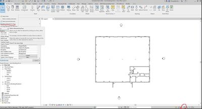

It is floor plan that I was talking about. Here is a photograph of the situation (prt sc was not suitable because it would not show the sign circled in red).
jay_colc

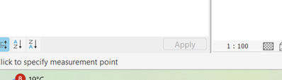

Are you trying to pick the Face of the slab?
"Select by face" is a setting under the Modify > Select .
It's also on the status bar on the far right, bottom.  Most things in Revit are selected by an edge but if you are trying to select something like a floor, which is usually under a wall, it is quite problematic.  So turn on select by face and it will select the wall face instead of having to TAB key select at the edge.
Jay Colcombe
Autodesk Certified Instructor
SabinaK4RXQ
Yes, I am trying to pick the floor face. I activated select by face setting, but nothing changed - I still can´t put elevation on the top of the floor (in floor plan view), even though I did it normally on levels below. Just the last level (rooftop) is problematic.
