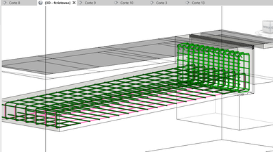

Hello guys! I've been working in some structural projects that have irregular shapes, so I have to create some angled section views, as it shows in the fisrt picture below.  The problem is, when i create that section, some elements just disappear. I've tried everything, phases, element graphics, I even aligned my rebars to the cutting plane, but it doesn't work. The pink rebar in pictures 2 and 3 is not showing in the section of picture 4. What should I do to solve this bug?
Thank you so much for the attention.

Hi @fcristovao ,
You did not mention the software version you are using. Try installing hot fixes for unstable performance and graphical issues.

can you upload your model, a portion of your model, so we can take a look at it?

Hello @PrathapSekar and @hmunsell.
I'm using Revit 2021.1.2.
Unfortunately I can't post the model here bc it's from work, but it's a bug where I cant see correctly my elements in the section cut. I mean, if my section cut is inclined (an angled cutting view, aligned to my angled rebar), some elements (like the inferior rebar, in pink, in the pictures) don't show up.

Even if I extend the view clipping, the rebar still doesn't show. I've checked filters, visibility, phases etc, but it keeps showing as Picture 4, although in Picture 3 we can see clearly that there's a rebar down in the slab.
