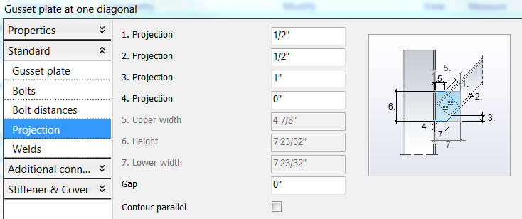

Recently, I have been testing this add-on in Revit 2017 to determine how much I could benefit from using it. In doing so, I have developed a few questions about some of the connection types.
1. When placing gusset plates, it seems like the software by default uses a 1/2" projection. Is there any way to change this to say 1"? Can you change certain default settings for all connection types?

Thank you for your very detailed review. The help for this feature can be found here: http://help.autodesk.com/view/RVT/2017/ENU/?guid=GUID-645A8C55-900A-42A7-8991-BFF6B2C7F6C6. Indeed, it doesn't go too deep in each connection's description, but we would gladly answer to your questions and also others that you might have.
1. Currently all the connection parameters are instance parameters. We have already registered a request in our database, to be able to define the defaults for connections parameters.
