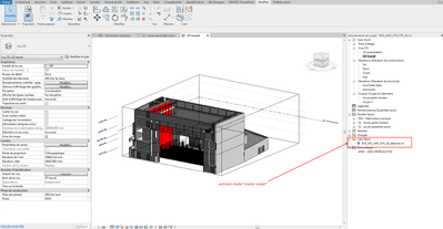

Hello everyone !
i'm new in revit and i seem to be lost with all these parameters...
I'm in trouble with the possibility to add a label on my drawings.
i've a model wich is linked to a reference rvt file see below:master.PNG
and i want to add a text line with the name of this model on my sheets. see below:générale.PNG
for the final result:détails.PNG
i've tried by myself but wasn't able to make it work....
Autocad can do it the attribute text by selecting in list elements.
How we can do it in REVIT ?
PS: i work in REVIT 2019.1

Hello @AntDrt,
Unfortunately, there is no way in plain Revit to automatically get information from the linked model into your sheet.
You need to create a project parameter and assign it to the Revit Category 'Project information'.
For instance the shared text parameter 'ARCH_Revit_Link_Info'.
That shared parameter you can add to your Title block.
I used this method several times for my customers.
See the screencast below:
Screencast:

Thank you !
it worked, i've intregrate this parameter in my prototype and it works well.
