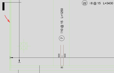

Is it possible to change the color of the assembly parts from light green to a  different color? It is impossible to see the element parts of the assembly with this color.

@Evgeniy_Kogan hello, you can try this, select the object > right click > overrides graphics in view > by element and change the colour. thanks
Evgeniy_Kogan
this does not help. there must be a solution for this I am sure this bothers other as well. Autodesk should have made solution for this till now.

I created a wall then divided it to parts and then each part I created an assembly.
In the assembly I want to add rebar, but because the light green color it is impossible to do this.

You can change background color to black.
Evgeniy_Kogan
thank you very much, this is the best way, although not very convenient. From the side of color change and transparency - no solution...
