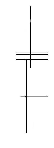

hi,
How could i make a lap splice for area reinforcement ?

You can only create that splice manually by adjusting the sketch of each area reinforcement so that they overlap by the desired distance.
The same goes for regular rebar sets.

this is hard to apply,
does autodesk working on a better solution?
ovidiu_paunescu
Currently splicing of rebar is a manual operation.
You can add this to the Idea Station so that others may vote on it.
