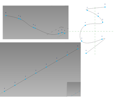

(IN GENERAL) The reason to use adaptive points in a family is to "place" or "host" those points onto "things" in your project environment and then the adaptive component family will reshape, or adaptive itself when those "things" move. The three adaptive families below would result in the adaptive component to look the SAME in the project environment.
So Since your family ONLY has adaptive points, I recommend you consider just building all the adaptive points in a straight flat line and go from there. It could make your life easier and this is only a suggestion.
