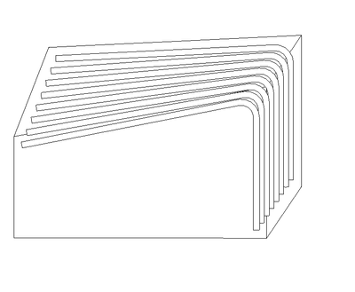

Hi all!
I have created a rebar set in Revit, but we want the rebars to follow a slope at the top (shown in red arrow) and stop at the same level. Please see the section and elevation screenshots. I tried to use 'varying rebar' command, but the varying direction (shown in blue arrow) is not the one we want. Instead of adjusting the rebar one by one to meet the slope, is there any way to get the desired outcome more efficiently?
Many thanks.

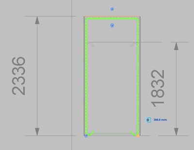

I know we can apply constrains between free form rebars and the concrete surface or cover. But I wonder, could we add constraint between free form rebars and other bars? For example, I have two stirrup sets, they are both free form rebars. I want the distance between the hook of upper stirrup and the hook of bottom stirrup to be constant, say 500mm lap rather than 1832mm in the snapshot. But it seems that Revit doesn't allow me to add constrain between two hooks.

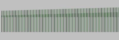

Just to show Free-form does provide a solution for multi=planar slopes for readers.
You can constrain to other rebars but it adds a another level of complexity to the Free-From set and possibly can cause small rounding/placement anomalies, therefore I would suggest either using the default Host -Face as this is a known and works for the other sets or as I have seen recommend here also is a dummy host to use for placement and constraint and hide afterwards using visibility settings.  I personally am not a fan of this but sometimes it has been the only solution for specific complex scenarios.

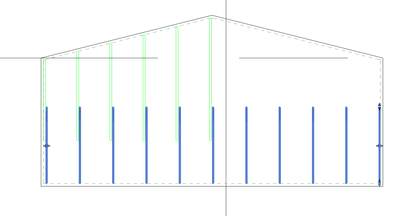

So in this example I have Varying Rebar for the Sloped Zone (Green) and Standard Rebar (Orange) for the main part of the element.
I picked the Varying Rebar > Edit constraints > Bottom Constraint > Hovered over the Top of the Standard Rebar
I picked the Varying Rebar > Edit constraints > Bottom Constraint (there are 2 references)> Hovered over the Top of the Standard Rebar Picked that reference and Edited the Offset Value
