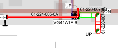

The way I understand it Revit is supposed to print what i see on screen as i see it on screen. Why is Revit not printing what i see on screen?
What I see on screen
 What is being printed to PDF?

Its set to thin lines and still printing incorrectly, but what I'm talking about is the overlap on the text. Don't really care about the lineweights need the next to legible.

Probably something to do with the printer settings regarding embedding fonts or using font substitution.

what PDF driver are you using? I have found I get different results with different drivers sometimes.

Are you using the "export to PDF" function, or a 3rd party PDF printer? If the latter, switch to the native Revit PDF function.

I dont even see an export to PDF function anymore, I know I've seen it before, tried microsoft to PDF and got the same result

Export to PDF was added in 2021 or so. Another thought, are those lines of text native to Revit, or something imported from CAD? Does it look like that for all text, or just annotations? How about dimensions etc?

They are native to Revit, just the annotations, the dimensions look like this

No its revit, your looking at a cut view of an existing pipe rack that we we'ren't provided backgrounds for so we had to import an NWD, not a sketch the piping is modeled content. Nothing goofy with the settings, it is a hidden line view, the only thing is the NWD background has been adjusted to be a little transparent. Just started happening on this project recently, not throughout the whole course.

If your method worked before, open up an old project where it worked and see if it still prints properly. If it does, something in your current project is off and you need to find out the difference. If the old project now also doesn't print properly, it may be something with Windows/PDF printer that may have changed due to updates. But ultimately really use the Revit export function. Not only does it work, it also excludes any goofiness with 3rd party (inc. microsoft OS functions) printers. Since we have native PDF export, I never used a 3rd party printer and never had issues. Also make sure you have everything up to date (Revit, Windows, and 3rd party printer if you really want to use that). I also have Bluebeam (but don't use it for Revit) and every once a while they need to update an update since something breaks. Again, use the export function to avoid any such hassle.

Emptied out the temp folder and it fixed the issue
