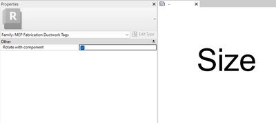

This setting below will always orient the label to be readable from the bottom or right side of the view, so never upside down or read from the left side:

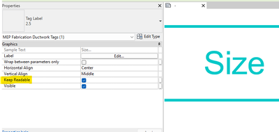

This setting will rotate the tag to align along the tagged component:
colegrovej
Both of the tags have the exact same settings selected. Yet they still behave this way
