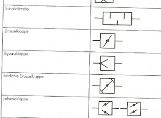

mechanical part ( about duct symbol):
I am pretty sure that this part isnt defined in ashrae standard, if I open ashrae I can find just this two symbols
but If I open default Revit template (USA) and draw a few duct (supply, exhaust, return):
and open a smacna cad standard : (https://www.smacna.org/docs/default-source/technical-resources/smacnacadstandard.pdf?sfvrsn=d921fda5...)
they look pretty much the same...
but the rest symbols -family symbols are very poor and require extra work on symbols and even many objects do not have a symbol...
But if I open some european template there is a different set (its obvious that this settings depends from country to country):
german template:
and families have applied much more symbols like:
BR
