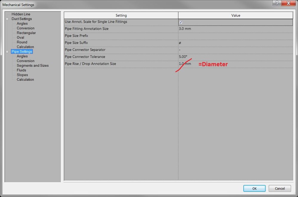

In revit 2016 - I think it is not possible to get real sizes of circles when sewage pipe is going vertically down or up.
There is only one parameter to deal with it which is: Manage/MEP settings/Mechanical settings/Pipe settings/Pipe Rise Drop Annotation Size.
But this parameter set a constant value: the same size of a circle for 50mm or 110mm or 200mm pipe, which doesn't show real size of vertical pipe.

When the Detail Level of the view is set to Coarse or Medium, then pipe will appear "symbolic". When the pipe is cut, the view will show a circle. The size of the circle is based on the Pipe Rise/Drop Annotation Size in the Mechanical Settings (as you stated). You can change this, but it will not adjust for actual pipe size. You have a couple options to show the actual size:
1. Change the Detail Level of the view to Fine.
2. Override the Detail Level for the Pipes category to Fine in the Visibility/Graphic Overrides dialog.
Below you see the settings for the Pipe Rise/Drop Annotation Size in the Mechanical settings dialog box.
Hope this helps you clarify your problem.

thanks everyone to answer me. But it only confirms that this is not possible to show real vertical pipe size in Coarse/Medium mode.
I wanted to suggest Autodesk to implement such functionality. It is important for MEP designers to see how much space takes a big pipe,
and how much takes a smaller pipe. I tried this way (picture below) but it didn't work.
Is here any Representative of Autodesk, who could confirm that such functionality could be implemented in the future?
In Magicad for Autocad it was possible 🙂
In pure Autocad also.
