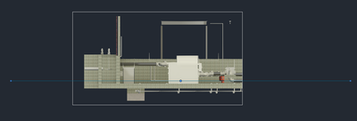

I'm trying to draw in a section of pipe, but I keep getting the error message "Can't draw because Work Plane is at a very sharp angle in this view. Go to another view or redefine the Work Plane."
When I try to redefine the work plane to something parallel to the view I want to draw in, I get the same message. This only seems to happen with piping; model lines, wall profiles, etc all let me redefine the work plan and draw in whatever view I need. Is there a different setting for piping work planes that's separate from the work plane for other functions? Is it related to the reference level somehow?

send us a screen capture of your workplane your trying to use. if you can highlight the pipe you're trying to connect too also.
  • set your view and work plane to draw your pipe
  • then go to a 3D view and select Show your Workplane.

For some reason when I select "show work plane" nothing happens, but here you can see the work plane highlighted when I try to place the new pipe.
What's really confusing me is that when I open the workplane viewer, it actually shows the surface I'm trying to use as my workplane.

All I want to do is connect these two fittings with a vertical length of pipe, but this is the error message I keep getting. When I try to do it in an isometric view, all it will do is change the fitting and give me a horizontal length of pipe.
Message 9 of 11
iainsavage
Cut a section view instead of using a 3D view.
Message 10 of 11
RSomppi
Section view should work.

Thank you both, that did the trick!
