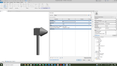

I created 3 family and all have the type A and  type b, but i don't know why the triangle align is not  in the center of Type B...

use Reference Planes and align your nested families to the reference planes.  Dimension to the reference planes, not the objects when ever possible.

@hmunsell Since you are using families if you are setting up a parameter to drive the movement of the reference plane it is fixed to then how would you go about moving the reference plane to the center of the family because you cannot drive an if statement with family types.

@pe_simon  I instead just created a reference line at the center of the cube family and aligned the nozzle family to that. It is working now here is the fixed family.
