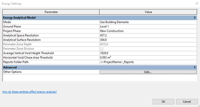

Just a few more screenshots
Wall (thermal) properties
Basic Thermal Analysis properties
Advanced Thermal Analysis properties

It seems to work now... On the Analysis ribbon there is a section called "Energy Optimization" which contains a button called "Energy Settings". The latter brings up the "Energy Settings" panel.
Make sure that the mode is set to "Use Building Elements". Then click on "Edit other options"
On the "Advanced Energy Settings" scroll all the way to the bottom and check the "Detailed Elements" option to 'true'.
So with those settings I ran the thermal Revit analysis again for different insulation thicknesses and this time it gave different 'Delayed Sensible Energy' for the associated wall.
