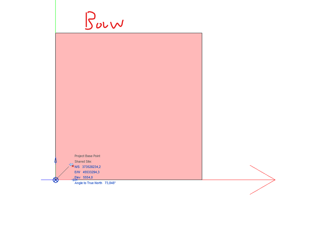

Good morning,
I have some questions about the survey point.
I have received 2 projects(via manage links linked) B and C (seen in the photo) from the architect.
It seems that the survey point has a difference.
I have now drawn my Mechanical installations and I want to upload them in a BIM Viewer(Dalux). It turns out that the mine installations (W in the photo) are not at the right height (photo added).
I have contacted Dalux and apparently they work with Survey point. So this must be equal.
How can I solve this? Since I never have to change the survey point in my project (it always remains fixed by the architect).

vitorbortoncello
Acquire coordinates from the linked model,
or Publish Coordinates.
https://help.autodesk.com/view/RVT/2022/ENU/?guid=GUID-651EE8A9-FCFC-4999-91C6-4628FBCED902
https://help.autodesk.com/view/RVT/2022/ENU/?guid=GUID-92EB55C8-A5C3-46C9-90F1-50E4FAD1548C

igoteseanu6NLUR
Great thank you !!!
