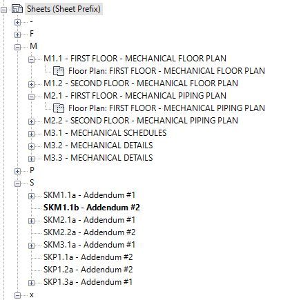

I would like to organize my addendum sheets. I would really like a header that says addendum 1 and addendum 2 but I know that may be stretching it. Is there a way to group these any other way?

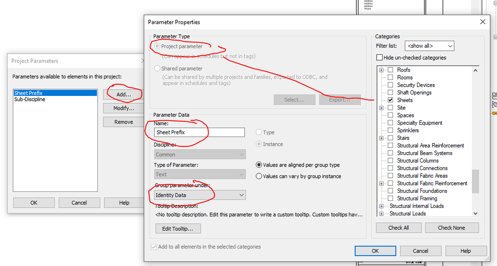

create a shared Parameter that applies to both views and sheets.
ADD1
ADD2
then you can sort this in your project browser structure a a Project Parameter

Thank you! I didn't actually have to add the project parameters. I already had one named Addendum Number which is already filled out for my sheets. I just used it to add another sort level.
Thank you so much!

See attached 2017 Revit file.

Thank you! This is great for the initial organization of my sheets and exactly how we do it. (I will be printing this out for my personal book that I reference when I need help) For this instance, I needed the extra step of distinguishing between the S sheets for Addendum 1 and 2. I just added an extra level of sorting.

That's fine.  But your non-addendum sheet groups will have a "?" below the Sheet Prefix header.

If you have no issues with ??? then all good!
Sorry I posted the wrong screenshot.

My issue with the Sheet Prefix way is that I have to tell it what the prefix is. Before, it was automated. Both concepts get to the same point, One is quicker and adds ??? and the other you have to tell the program what the prefix is.
