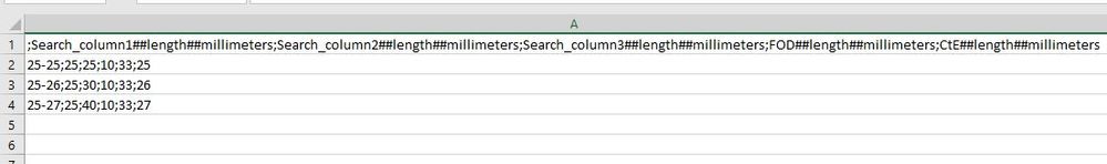

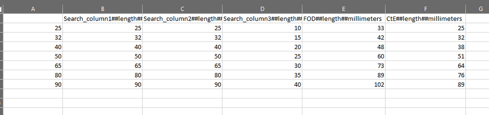

robert.klempau
Hello @Secttor,
The way Size lookups work is:
let's take Value 1 as an example.
we are looking for a value in a column that has the name FOD.
we search for a value in column B (Parameter Search_column1) then for a value in column C (Parameter Search_column2) an then for a value in column D (Parameter Search_column3)
If the combination is found, then it will return the value for column E.
If not, he returns the value 10mm.
If you want another search column, just add a new column in your CSV file between column D and E and add a parameter at the end of your size lookup formula.
When I look at your formula for Height, it will return 500 if B or C is greater than 25 because the size lookup can't find the value 0 in column B (DN)
please see the attachment for the family I created for you.
