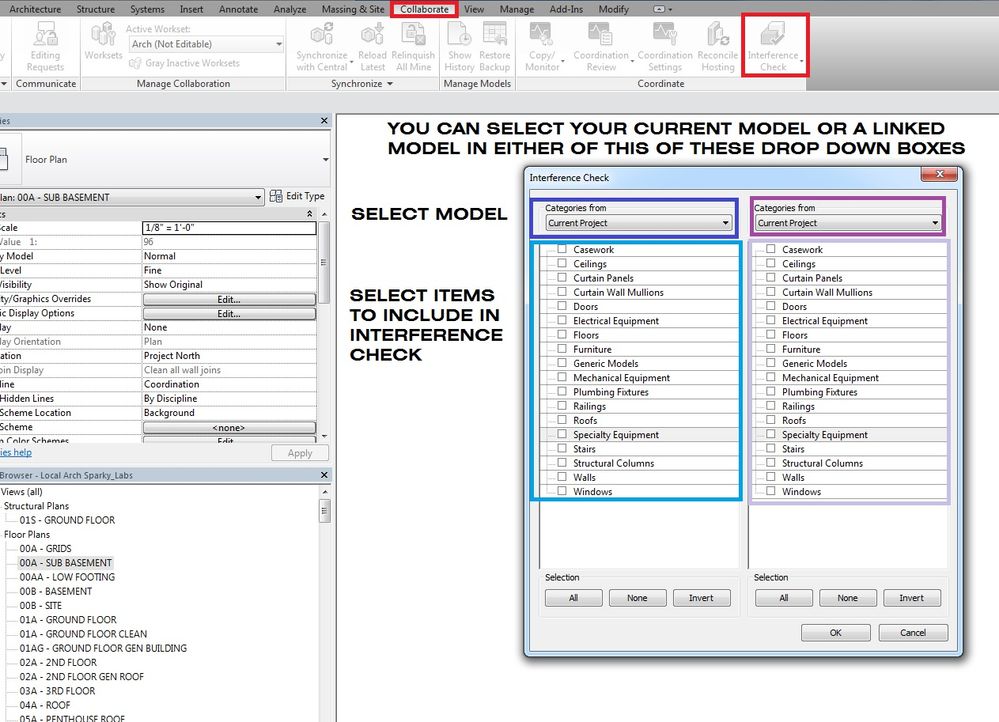

  • conflict detected by Revit gets compromised... This is blatantly false.  Conflict detection is never compromised, be it within one model or 100 models.  Here is a screenshot:

I have on many occasions used Revit's interference checker to check for interferences within my models and other models.  If it didn't work for Mercado, Mercado should have said something specific about it.  Example: mechanical's duct and plumbing's pipe are in clear conflict with each other but revit's interference checker completely missed it ... here is the proof (provides a few screenshots).  In this example, Mercado's claim is completely validated from the proof he has given.
