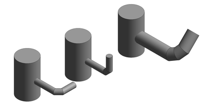

I have been searching for a solution to rotate a nested family through x axis. I am having zero joy achieving this and have received so many error messages stating the object cannot be rotated to that position.
The outlet needs to host a pipe connector, and because autodesk seemingly likes to make things more difficult by removing visibility controls for connectors I am ready to throw my PC through the window.
I am now aware Sweeps don't work, I have generic models, non & work plane hosted and I just can't get it to work.
Please help, and don't try to show off. I want the simplest way to do it, and that includes creating 3 types (left hand, right hand & vertical) which control the angle value.

Have a look at attached family. This is one way of doing it.
The pipe can have differetn length and heid, different radia, different bends and segment and you can set the the angle (e.g. -90, 0 , 45)
The rotating pipe is a nested family. Inside that pipe family with rotation I have created a non-rotating family of the pipe itself. There I can control radius, length, height, bend and segments (and more if needed).
I selected "workplane based" and deselected "always vertical". Loaded this non-rotating pipe in the host family.
There I created a reference line. This reference line is used to create the rotation. I place the nested family and then edit the workplane and select the reference line as new host. Now it will rotate with the reference line. Then add some constraints to prevent things from moving around. Passing through relevant parameters and adding a rotation parameter to the reference line. This family I can now add to the "equipment" family and position it on the right spot. Again passing through relevant parameters that I want to control. Also placing a connector on the pipe.
It is indeed not as straightforward as you might expect. But once you get the hang of it, it is relative easy to do.
Because it is is a nested family you also can easily reuse it on more places and in more families.
You can study the attached family to see how it can be done.
