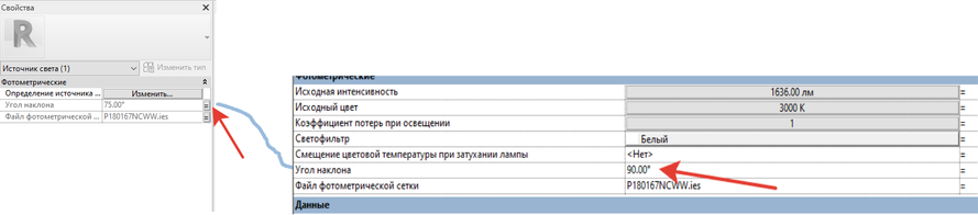

Nest the light source family in your light fixture family then you can rotate it however you want with an angle parameter.

2021-02-09_21-35-57.pngI have been struggling with this problem for a very long time, I organized the rotation using formulas using sin and cos, binding it to the reference planes, and the rotation of the ies file itself through the parameter.
I attach the family. It seems to have solved this problem, as it seemed to me, but it turned out that some ies files are incorrectly substituted, across, incorrectly positioned. And if we rotate the light source, it will be impossible to rotate it in the required plane. My opinion is that developers should add a tilt angle in 2 planes.
PS is difficult to explain through a translator, study my family and it will become clear that I almost solved the problem, but not completely.
