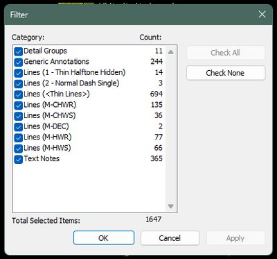

Our company is slowly moving away from AutoCAD to Revit for all of our MEP content. We are in the process of making installation details and single line diagrams in drafting views and noticing very poor computer performance when editing. This manifests as 'compute time' between actions such as copy, move, trim, etc. which heavily impacts drafting speed.
The view I am working in today has 1600 elements as seen in the snip below.
I tried deleting out the generic annotation families, which we use to nest symbols for pumps, valves, etc. without significant improvement. I also tried using the temporary hide feature to isolate areas, no improvement. The only thing that works for me is to create a blank drafting view and copy areas I am working on into and out of that view and the main view. When in the 'cropped view' there are no performance issues.
What I am stuck with is a hacked workflow. While I understand that Revit is NOT AutoCAD, the degradation of very basic 2D performance is not something we can compromise on as our company spends many hours in 2D drafting. The benefits of keeping everything in Revit are enough to overlook this issue for now, but I am wondering if there is anything else we can do to improve this efficiency.
Computer specs: i7 13700k, 32GB of DDR4 RAM 3000 MHz (issue with BIOS due to 13th gen intel is limiting here, but confirmed to be an issue on other computers), RTX 3060, M.2 SSD.

Maybe I am unclear. The pump and chiller shown there are import symbols from CAD, but the other items circled are already annotation symbols. Is there a significant performance loss from using annotation symbols vs detail items? Even in views without imported CAD, i.e. only detail lines and annotation symbols, the performance starts to really fall off over about 600 elements per-view.
Yes agree, detail groups are good for other things but not in this case. No detail groups are used in our single line drawings. And yes, heard on the CAD importing. We have a process to do that and I'll go back through with a fine tooth comb to make sure they're not 'over detailed'
I'm more trying to figure out why we are having performance issues with these views. Even if it's just lines the performance suffers.

I have not found a one-size-fits all solution to this problem. However some performance issues I have been having were related to central model location. We have a company server that hosts this model and when more than one user is in the model it lags severely to work the whole element ownership/permissions thing that Revit does. The company server is approx. 350 miles and one regional server away from me, hence the lag. (My local ISP is Kansas City based, company ISP and physical location is Dallas). I've tested this with both large and small models. That issue manifests as lag between actions - every command in drafting will take approximately 1-5 seconds to commit as it pings the central to make sure I can edit, actually commit the action, then pings the central again to update the element ownership.
I believe the best course of action to solve the issue above is to move to cloud based models, but am unsure if we would have the same issue. I'm not willing to test it on this project in particular but will test it in the future.
The actual model performance, framerate and time-to-commit actions, is still affected by the # of elements in a view. I tested this by saving a detached model onto my local computer and performing common actions. The performance is not snappy quick like it is in AutoCAD but it's acceptable. There are roughly 1700 elements in this one view on 30x42 sheet size including detail lines, annotation symbols, text, detail groups, and CAD import symbols. I can bulk select copy everything on the view and paste it within 1 second which is perfectly fine, and performing actions such as trim/extend to detail lines within the view is practically instant.
