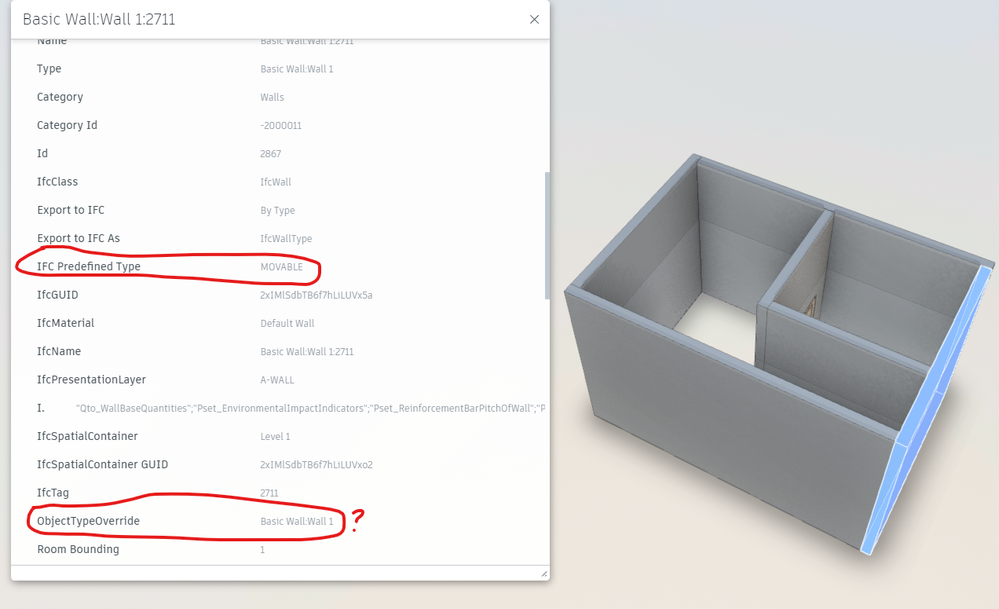

I experienced the same problem, the "IfcExportAs" is not working any more. The parameter is replaced by the built-in "IFC Predefined Type".
However, if I use the old parameter "IfcObjectType", the value will override ifc parameter "ObjectTypeOverride"
I attached 3 cases for more understanding.ifc-11.pngifc-12.pngifc-21.pngifc-22.pngifc-32.pngifc-32.png
