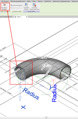

unable to draw reducing elbow in Revit I am tired of changing the welded generic family connection size but its changing at both the sides
I want one side of the elbow it should be 150 dia and another side I want 100 dia is there a welded fitting family that supports this change.
please let me know how to fix this in the elbow family

Sounds like you need a blend with two different diameter dimensions/parameters.
The standard elbow will probably only have one diameter parameter which is automatically read from the pipe diameter.

aeidAEEEF
I think you have to assign one of the connectors as primary. see below.

iainsavage
Standard elbow families are usually just a sweep with only one pipe diameter/radius parameter driving the geometry.
A sweep can't have different diameters at opposite ends no matter which connector is designated as primary.
Swept blend with two different pipe diameter/radius parameters to flex each end separately would, in my opinion, be the solution.
