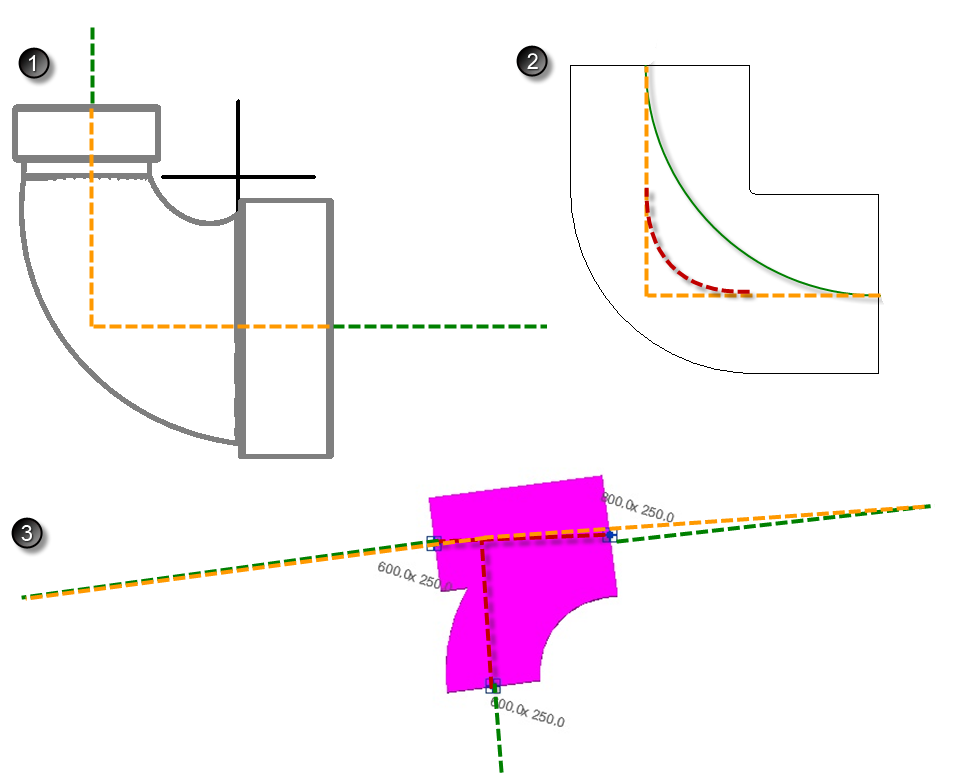

Hello FabZico... as far as projection, I was just referring to using vector math to find the intersections of the connections... there are no special methods that I am aware of, but there may be some vector math libraries that are generally available that may help.
The assumption that at an elbow the distances from the connector to the 'center point' will be equal isn't necessarily always true.  A reducing elbow (1) won't have this case.. similarly, some duct fittings may have a longer length on one 'leg' than on the other.   the approach is interesting... however, as you can see in (2) below, may actually come up shorter than the 'average' path... the green line is using the method you proposed.. the orange line is using the project-into method... and the red-line is probably what some may consider 'average'.  In the application I had worked on, the accuracy wasn't critical, and simplicity was a necessity... so the 'orange path' is what was used.
(3) basically shows the same method applied to the tee. The red lines indicate the 'projection', the green lines indicate the 'true' duct path, and the orange line represents the 'projected' duct path.  You can see there is some 'error', but depending on the application, it may or may not be critical.  9-14-2012 12-15-43 PM.png

Thanks Martin, you are correct, and reducing elbow is one of the issue that i missed out, thanks for pointing that out,so A is not always equal to B, A is equal to B only if the in and out length of the elbow is equal, for my method, an additon in-and-out length check will be required.
