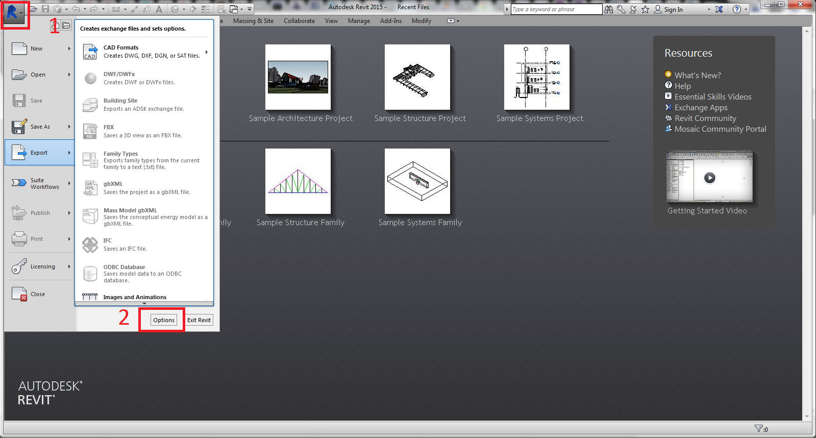

How can i turn off project srat screen? I mean when i turn Revit there are recent projects. Is there a options to hide this recent project and start revit on empty screen?

Yes there have an option to turn on/off recent file list.
Start your Revit -> Click to Big "R"left top corner on screen -> Click options -> User interface -> Uncheck Enable recent file on start up
Here is official Autodesk help link: https://knowledge.autodesk.com/support/revit-products/troubleshooting/caas/sfdcarticles/sfdcarticles...
