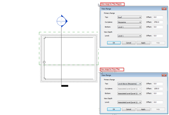

Here is a sample building with two rooms on Level 1 (one is open to above), and a mezzanine room.
I want to create a first floor reflected ceiling plan and show piping P1 and P2. Piping P3 should not appear on that plan view.
I use a "plan region" for to do that, but it doesn't work: the P3 piping is still visible, but fittings disappear.
The plan region feature never works for me as I expect. Can I make it working as I need?
Here is an attached sample project. I would be appreciated if somebody can fix the RCP view there.
Thank you,
EK

It is normal behavior when the fittings are within the view depth range but outside of main range to become invisible, while pipes are visible, as expected.
The view range does not work well with MEP categories.
A workaround is to hide the components you don´t want to show, not the best way.

Playing around with the issue, I found following facts which guided me to a better solution and perhaps something that Autodesk needs to improve;
  • Within mechanical objects, this only affects some ducts, duct accessories and apparently whatever is longitudinal. Perhaps cable trays and pipes as well.
  • Only objects close to plan region edges are affected. How close depends on object’s length.
  • Objects with angle greater than 45 from the closest plan region’s edge are not affected.
Solution;
  • If object can be sliced in smaller pieces, making the object shorter may resolve the issue. Again how short depends on how far the object is from plan region’s edge.
  • If the plan region’s edge can be dragged further from objects, that may resolve the issue.
  • Changing the plan region’s boundary so that it makes an angle larger than 45 with the object may also resolve the issue.

The reason why your plan region doesn't is that the direction of view in the RCP is looking upward while the Plan region is looking downward.
In your case you're using RCP with a cut plane 1200 looking upward (through your roof level) which means you can see elements from level 1 with 1200 elevation through the roof level and placing a plan region in mezz. level with a cut plane of 1200 looking downward which means your plan region is showing elements from mezzanine with 1200 elevation through the level 1.
 In plan region you're not supposed to see the pipes however you are working in RCP plan and view range (looking upward) which mean you can see the element through roof level. In that conflict the plan region feature never works as you expected.
Using RCP you have to hide the components you don´t want to show just like @fabiosato mentioned earlier
Using Floor Plan to achieve that view.

create 2 separate views for your ceiling, with an overlap or datum for reference.
adjust your view range for each view to get the result you want.
view 1 displays the low portion
view 2 displays the high portion
overlay them onto your sheet

I think the distance from the Plan Region is driven by the Mechanical Settings:
The gap size in given in paper space. The real life distance from a linear element (pipe, duct, conduit, etc.)to the Plan Region edge depends on the view scale. For scale 1:100 it would be 160 mm. If we want to change the view scale to 1:1000 then we should increase the distance from the linear element to 1600 mm.
