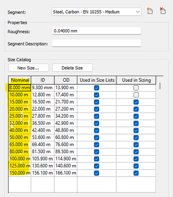

For a project the stakeholder want us to draw old installations into BIM so they can build up an material library. Now i have an old heating and cooling revision where they speak about NW dimensions and so far i know is this a German standard like DN dimensions. The question is does someone know if there a Revit families with those NW dimensions? Or is it easier to draw in mm?

Revit allows you to designate actual inside diameter, actual outside diameter and nominal diameter for any pipe type and you have freedom to designate these to your needs.
For example for steel and iron pipes it is usual to designate the pipe by nominal size for example 15mm, 20mm 25mm etc rather than actual bore or outside diameter:
For copper and plastic pipes (in UK and EU) it is conventional to designate them by their outside diameter and in Revit this is done by making the nominal diameter the same as the outside diameter:-
So you can set it up whichever way that you want.

Regarding fittings and accessories, the pipe connectors always read the pipe Nominal Diameter and then if you want to instead set different diameters (for example actual outside diameter of a fitting, wall thickness etc) that would be done by means of formulas or lookup tables.
I found this site for high vacuum BIM/CAD families  but you may have to create your own (or modify existing families). Often you can get a 3D CAD file which you can import into a Revit family and then add connectors and informational parameters to make it function (sort of) as a Revit family.
