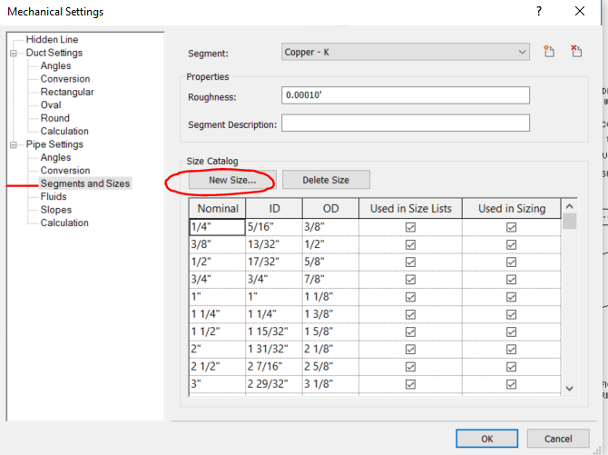

When creating a piping system in the real world, pipes come in measurements of feet or half foot Rivet employs fractions and so on how can I change the measurement of this. Also how can I get rivet to add automatic t joints or elbows for piping.

Revit allows you the options to modify /add /or remove sizes of most things
on the Ribbon find the Manage Tab / Mechanical Settings.
select the segment and define what Pipe type you want to modify the sizes of (Copper-K)
add and/or Remove the sizes for that segment type.
I recomend not deleting the default setting but create a new size for that segment
