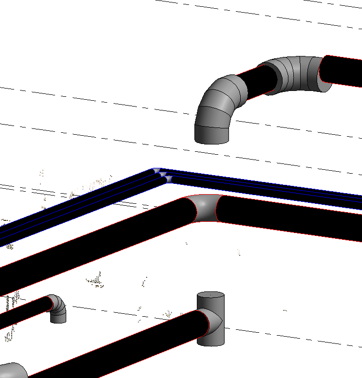

Capture.PNGSo I am trying to draw a pipe from that T-Bar to the Pipe Fitting above.
Message 4 of 10
tim102289
From your screenshot it looks like you are trying to go from the tee to the elbow above it.  You could make a section view to view those pipes from the side, and then you should be able to easily connect the two fittings with a pipe.  Another option would be: in plan view, if you draw a pipe, then change the offset, and click Apply, it will draw a vertical pipe.

if you are trying to model a pipe in the 3D view it really doesnt like you to draw vertically... to do it:
1. Select the pipe command
2. Click where you want your first point to be.
3. Type an offset in the "middle offset" box (if the pipe is starting at an elevation of 10' type something like 10.5' or 9.5' depending on if you are modeling up or down)
4. hit enter and move your mouse back into the 3d space (it should give you a preview of the pipe)
5. click apply.
6. now just click the pipe and manually connect it to your tee.
Message 7 of 10
I tried that, and for some reason doesn't want to work. I saw a solution for the fitting, a button that will rotate it for you, on the pipe fittings, there is a rotation symbol on the elbow, but only when I select Rotate after placement for the elbows, I was wondering if there was an option for pipes? Anyone know?
Message 8 of 10
Did you try drawing the pipe in a section view?
Message 9 of 10
I tried that, and for some reason doesn't want to work. I saw a solution for the fitting, a button that will rotate it for you, on the pipe fittings, there is a rotation symbol on the elbow, but only when I select Rotate after placement for the elbows, I was wondering if there was an option for pipes? Anyone know? Yes I tried drawing in section view as well.
