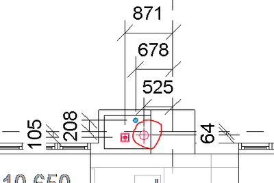

Some of the sanitary pipe in plan view only shows cross line as shown on picture.
I want the pipe all shows like this.
How can I solve this problem?

Check the detail settings of your view (fine, medium or coarse) and check your ris/drop symbol settings for your system.
This might be different for sanitary than for some of your other systems

waldo9QBRP
Hi L.Maas,
Is it possible to remove the cursor/plus, instead of the rise/drop symbol?
Or is it possible to adjust the line thickness of the cursor?
Message 4 of 8
craigjonnson
What are your cut line weights set to within your visual graphics > Object styles? Change your centreline to 1 if its any number above that.

waldo9QBRP
Hi craigjonnson,
Your respence is highly appreciated.
The centre line was thick even if the pipe were not cut.

Mahmoud.Ziedan
@waldo9QBRP Pipes are not cuttable elements.so they just have projection line weight
Adjust the overrides for rise drop symbols:-
Message 8 of 8
fabiosato
In visibility/graphics overrides, hide the centerline.
