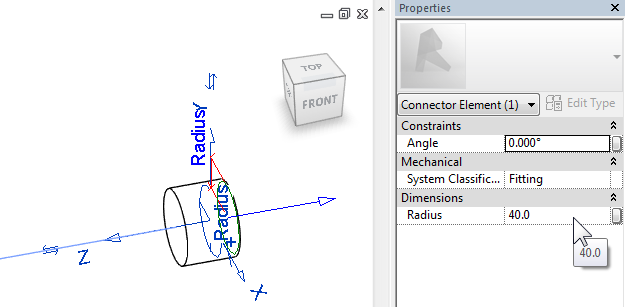

I have tried to get a pipe tap to represent correctly
I am new to revit and am sure im missing something
I am using 2012 (forced to by client requrements)
My tap is  appearing at the default od of 48.3 regardless of the pipe size attaching
I would really like this to work for me
I have attached files and screen shots

AVysotskiy
Hi Pete.
Unfortunately I can't check this family on Revit 2012 - I even haven't got installation files.
If you want add 6mm to the pipe diameter and leave it at that you should write in the formula field of parameter Out Side Diameter value Diameter + 6 (or Diameter + 6 mm).
BUT there is one problem in your family.
I tried to use formula above - it works in family, but not in project :
Why and how to fix:
You added parameter Radius to both of connectors in tee family :
This way Revit tries to pick both of connector radius to set tap size.
You should remove association for connector on the side of bigger pipe:
Now it works perfect without using CSV files :
