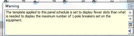

Here is the warning:

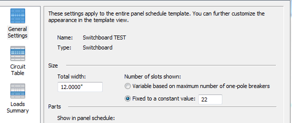

We have changed nothing with our panel templates and/or the equipment circuited to the panels. We are now getting this warning on all our Switchboards. No idea what happened. What we need is a panel schedule to look like this:
This is after I changed the the fixed max to 22.
The max on the family obviously has to be set to at least 61 to accommodate the circuits needed.
To not get the warning (ABOVE). I have to set the fixed max in the template to 61. But, then I get empty space all the way to 61.
How do I get the panel schedule to only show circuits to 21? Not having all these empties. We have not had any issue with this until this week. I'm probably missing something simple. But, starting to get a headache because of this.

Scott_D_
If you create 20 circuits and load a schedule that will only show 18 you will get this error, this is when you change the schedule to one that has less available total ways than that required.
To fix your formatting error and get rid of this error edit the board template to have a very large number of ways, set the text justification and size for each column then change it back to display the ways based on the number of ways the panel is set to have rather than a prefixed quantity.

Look at your very first set of screen caps - in the panel schedule template settings, you have chosen "set to a fixed number of breakers (22)".  Choose "variable based on Max # 1 pole breakers" instead.  Or set that value to 22 in the properties of the panel itself.
That error is popping up because the number of breakers in your panel (presumably the default 42) is larger than the number of lines you schedule template will display.  You have to make those values match, or make the schedule template adjust itself automatically to each panel (I very strongly recommend the latter).

Exactly. My question is how to get the panel schedule to adjust itself automatically to each panel? To only show the slots that have information being pulled into the panel schedule.
If I have a switchboard with 12 panels circuited to it, each at 3 poles. That switchboard would need to have the, "Max #1 Pole Breakers" set to 60.
I set the number of slots shown in the panel schedule to, "Fixed to a constant value" of 20 to only show the necessary information in the panel schedule.
In my panel schedule only 20 lines need to be shown. Not 60. Because I am showing the "Total Load Only per Circuit." Which produces the warning we are discussing.
If I set the Number of Slots Shown in the panel schedule to "Variable based on maximum number of one-pole breakers." The results in the panel schedule now shows 40 empty spots after the last panel in the 20th spot. Which is exactly what I don't want.
