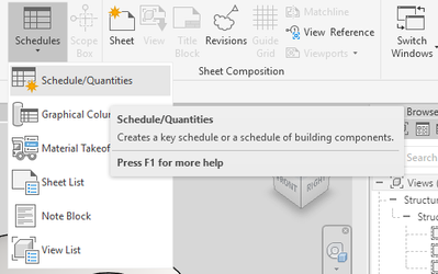

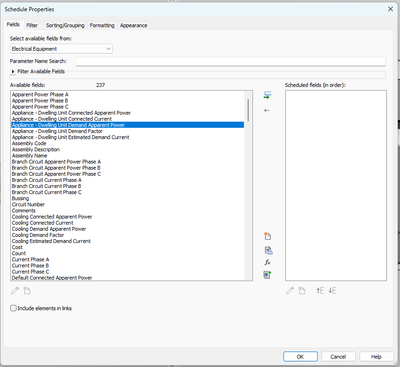

Crystal_Duck
Because those parameter is located in electrical equipment"
You have to use "schedule/Quantities" feature to get the data you want.
Select "Electrical Equipment"
Select the parameter you want to schedule here
Hope it help.
