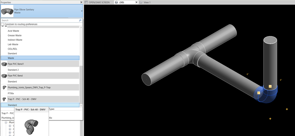

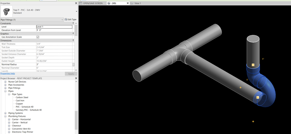

When I go to load my p-traps into my model they come in with the incorrect orientation. I'm using the sample p-trap family so it shouldn't be an issue with the family I wouldn't think. If anyone has seen this before I'd appreciate the feedback. Pictures included below for clarificationP-TRAP1.pngP-TRAP2.png

Personally I think the P-trap family has been designed to be nested into plumbing fixture families rather than used as a stand-alone component, but that's just an opinion.
I've never had success getting it to insert correctly on its own and always end up having to disconnect it, spin it around in a section view and then reconnect it.

I would suggest making the p-trap part type value Multiport and inserting it manually, using the spacebar to select the desired end to be connected.

RLY_15
I'm not at a workstation to check, but I recall it having to do with either:
- Pipe drafting direction (drafting from fixture to main is consistently correct for me)
- Pipe system flow direction, which you would not currently have established in the photo as there are three connectors open
EDIT: Gave it a go. When you draft from the main 'up' into the fixture, the trap position winds up being on the wrong plane like in your example. If you are using plumbing fixture families or any family with pipe connectors, using the Connect Into command, clicking the connector graphic to start the Draw Pipe command, or right-clicking the connector and choosing Draw Pipe will all guarantee that the drafting direction (I need a better term for this that is more modelling-appropriate) is correct for p-trap alignment.
And for what it is worth, the P-trap family I'm using is the OOTB one, with Part Type set to Elbow.

I've consistently encountered this problem, and the given solution has not helped. Here is what I found to solve this problem:
- start with 90 degree elbow
- change the fitting to a generic revit elbow
- change the fitting to a p-trap and it will be in the correct direction
Seems tedious, but I found that it is quicker than trying to fight redrawing and reconnecting.
