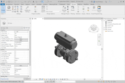

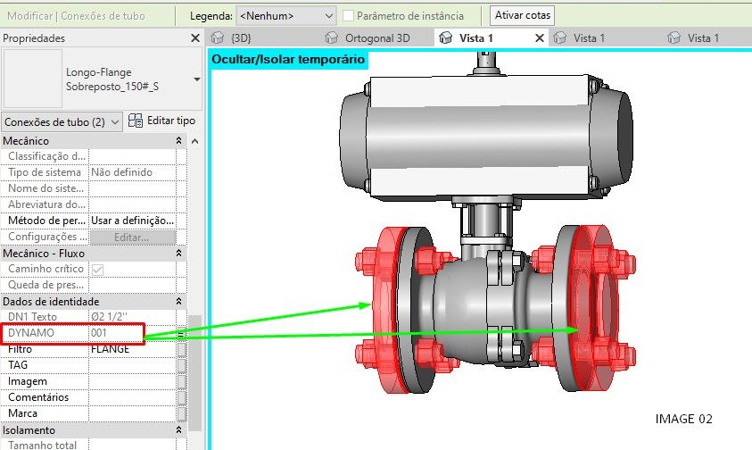

Hi, @alexandrelongo. You are doing everything right. But to speed up this process, you can use the capabilities of Dynamo. For example:
1. There is a parameter in my family that passes values ​​to all nested families. I fill it out to quickly filter the elements to add to the assembly.
2. Open the view in which there is the desired assembly and all nested families.
3. Open the dyn file (from the end of the message), select the assembly, specify the parameter and value for filtering elements.
4. Run the script.
Dynamo you can find here:
Best regards, Pavel Plotitsyn.

Hi! You need select assembly. Parameter is correct (instance, not type). Don't forget associate your parameter in nested families and open the view in which you can see the desired assembly and all nested families.
