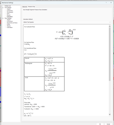

Message 10 of 12
KoosU
If you go to MEP settings, there is more than one way that you select the calculations to be done.
Message 11 of 12
