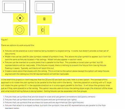

Workaround Explained in the below article
https://www.augi.com/articles/detail/hope-for-the-slope
