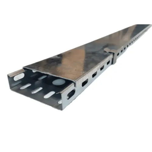

hi all
can any1 please help me and tell me how can i make a Lid/Cover to my cable trays?
when i view sections i want it to appear with Lid/Cover.
ty very much.
maybe u can help with cable try family or somthing close to it.
thanks in advance

revit cable tray is always open upwards, you will never be able to close it. revit families are LOD 100 to 200 so dont usually worry about lids etc.
one solution is to model the lid as a seperate family, and place it where required.
FABCAD has much better solutions for trunking with lids and corner, tee pieces etc.
look into fabrication modelling in revit, its so much better than the revit stuff.

Hello, Creating an inplace family in cable tray category will be better as it need to be reflected in BOQ. Cable tray lid is required in certain conditions to protect the cables from moisture of the surrounding.

Cable Trays in Revit are System Families, you are not able to edit them.
I would look into creating your own Cable Tray Family and then you can add a Lid/Cover and use the Visiblity parameter to turn it off/on etc.
The other option is using Fabrication Parts, you should be able to find a cable tray with a cover or lid or create your own.

Batter to make separate family or Model in place familyEarthing detial-2.jpg

johnl5PYL9
"Honesty I have never seen a lid covering a cable tray and I am not aware of any of those in Libraries I know." Really? https://www.goactive.nz/storage/media/2020/10/1603842022-2090006atk.pdf PLD_0.webp
