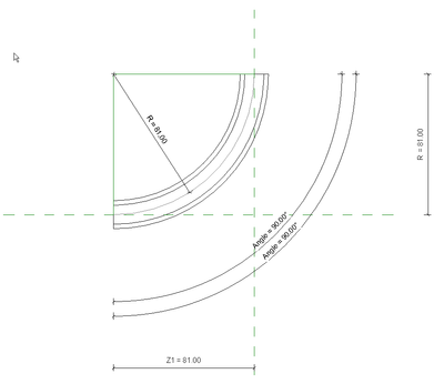

I want to input a different K Factor for my custom Revit pipebend family (Or use any alternative method)
The Revit family creates an instance pipecorner that can have a Different length and Nominal Diameter and I want to input a different K factor depending on these parameters. However Revit does not allow me to use Instance parameters for calculating the K Factor.
I was wondering if there are alternitive ways to output a correct K Factor. Or maybe other tips that might help me solve this problem. All help is very much apreciated.
PS: Also I have look into this post, however as far as I understood this will not help me solve my problem. But to be fair I also don't fully understand the discussion. (Solved: Re: Custom K factor calculation for pipe fittings. - Autodesk Community - Revit Products)
